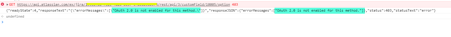

I am using OAuth 2.0 for authentication and using that i am calling all rest APIs.
Till now it works fine but whenever i am trying to fetch Choice field options using rest than getting error.
Below is the rest i am trying to call.
https://api.atlassian.com/ex/jira/" + jiraCloudId + "/rest/api/3/customField/10005/option

Hello @Administrator Admin ,
I believe this is the same issue that is being currently discussed in the below thread:
In short:
By reviewing the documentation, it definitely looks like:
- Oauth 2 (3LO) is not supported for the Issue custom field options endpoints (no OAuth scopes required).
- Oauth 2 (3LO) is supported for the Issue custom field options (apps) but they can only be used for custom fields created by apps.
I am waiting for DEV to confirm this is the case and/or provide more details on plans to have this implemented.
Please review above thread and follow it for updates.
