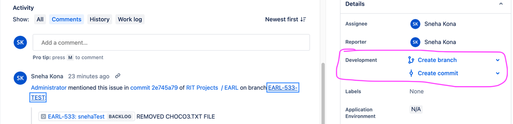

I am testing the Jira cloud migration on free trial. I'm integrating a self-hosted GitLab instance with the Jira cloud. I have tried the Integration using "GitLab for Jira Cloud" app  using  below method didnt worked. https://docs.gitlab.com/ee/administration/settings/jira_cloud_app.html#failed-to-update-the-gitlab-instance
After then I did tried the Integration using the Gitlab Integration with Jira
It worked However, I've encountered an issue where commits and branches are not linking correctly to Jira issues. Although commit messages are visible in the comments section of Jira, the specific sections for commits and branches in Jira do not display the commit numbers and branches as you can see in below picture.
please advise what is the issue and how to fix this?

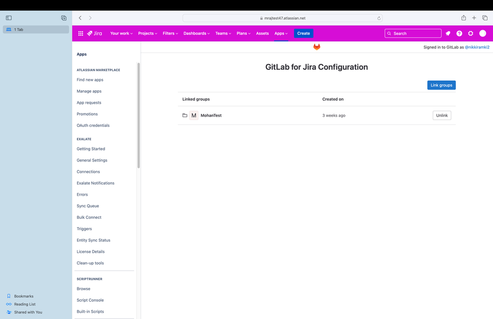

Hello, Good day. Please go to Settings >> Apps >> manage apps >> Expand Gitlab addon >>  and make sure "linked groups" is available.

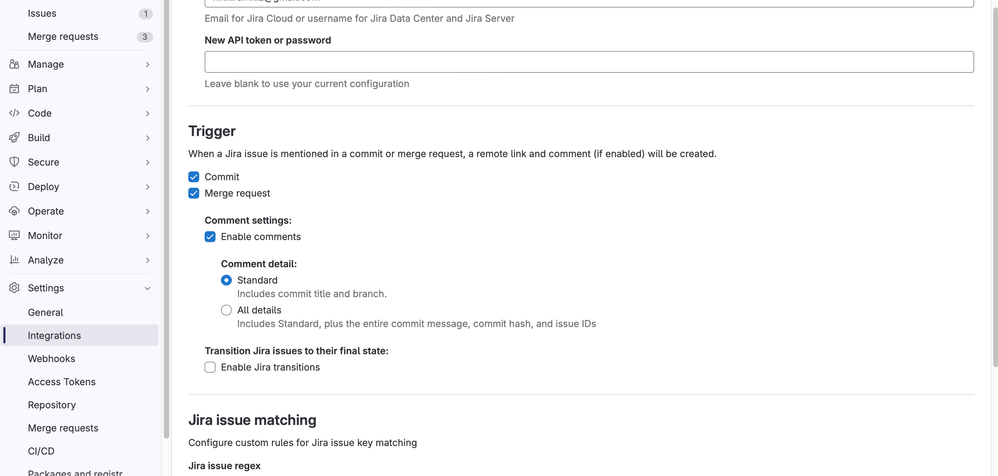

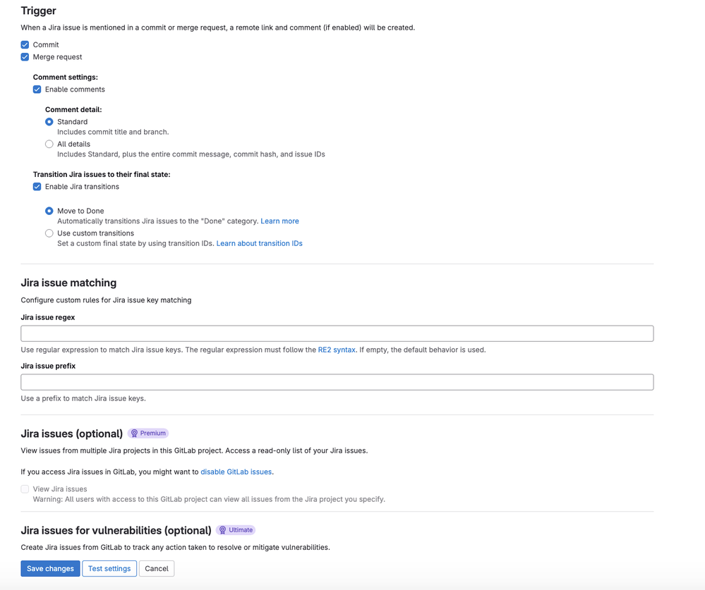

If this looks fine, you can also check the settings on Gitlab side. Project >> Settings >> Integration > Jira.

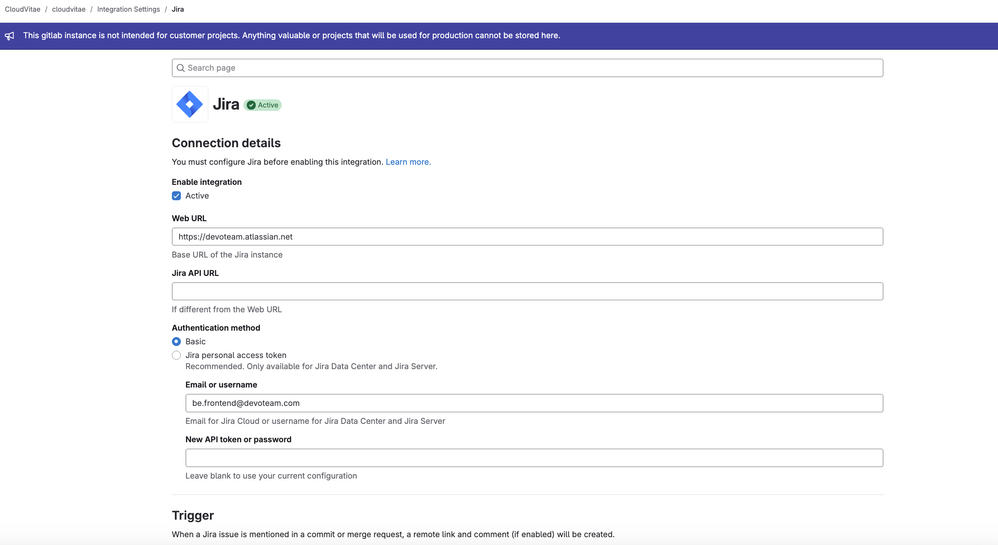

Could you provide a screenshot from Gitlab > Project > Settings > Integrations > Jira
Mohanraj Thangamuthu
October 3, 2024
We have reported an issue for the delay in sync as well.
https://jira-software.status.atlassian.com/
Like christos_dragios likes this
christos_dragios October 3, 2024
Ok thanks for raising an issue.
It is a new set up and I've noticed the delay in sync from start:Screenshot 2024-10-03 at 13.35.22.pngScreenshot 2024-10-03 at 13.35.42.png
