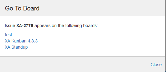

You should be able to go to the Issues view, enter a filter with the project name and appropriate status to get a list of those items. You can then pick one, then in the "agile" section, click the View on Board - it will then display the appropriate board if it is shared, or possibly give you a list of boards where the issue appears.
boards issue appears on
