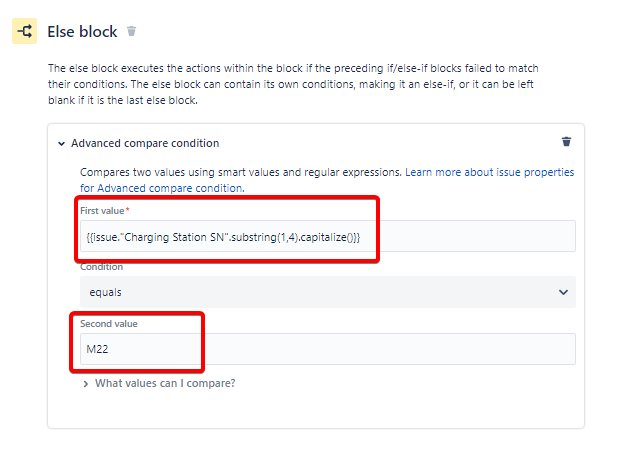

In fact when they have selected the product name in the list for exemple :
123ABCD45678, in fact out of this name, the caracters at position 2,3,4 is the product type group
From an automation IF I need to check this product type ID out of this string in order to populate an other field with the type
For exemple I have define a IF condition in Automation as below
From my rule above, that means if my field contains in 2,3,4 position the string M22, then I will edit an other field in the form and set it to HB2
This works fine for one condition but what I need to to check different value as below
IF {{issue."Charging Station SN".substring(1,4).capitalize()}} EQUAL M22
OR {{issue."Charging Station SN".substring(1,4).capitalize()}} EQUAL M23
THEN myType = HB2
I could not find a proper condition which allows be to implement this in Automation
Any idea ?
