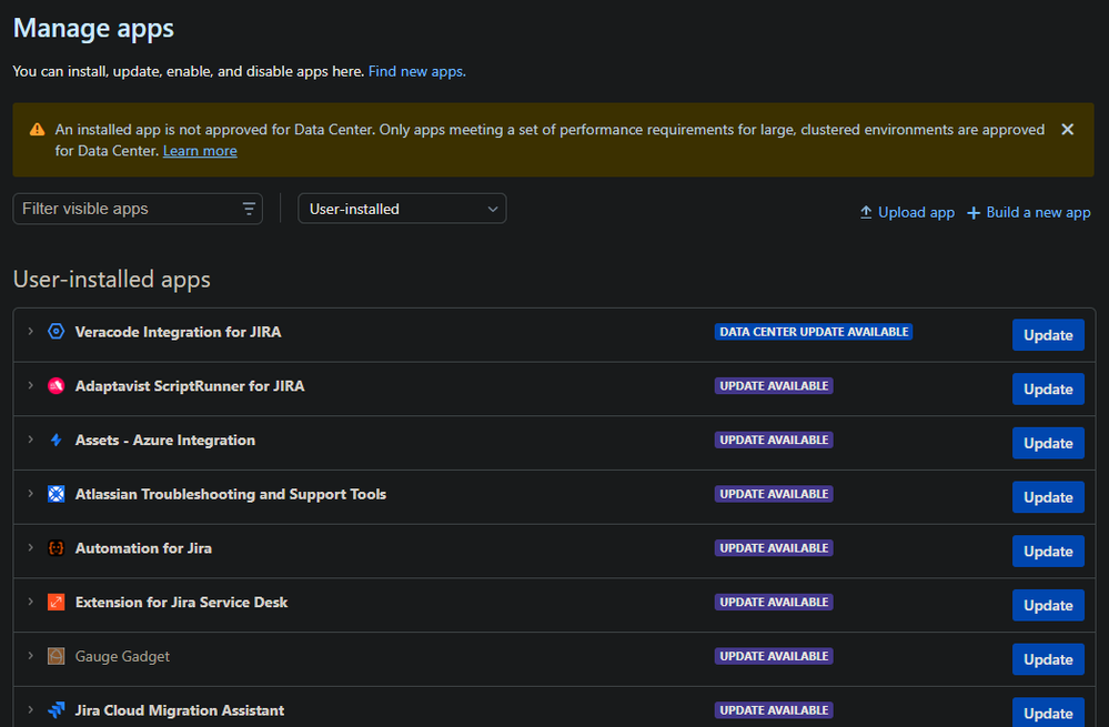

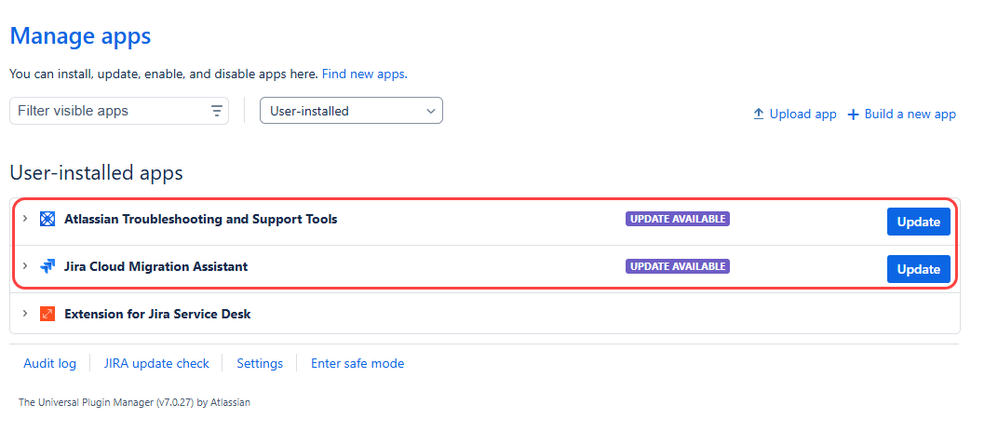

  8. Went to the Manage Apps page. I should have seen a dozen add-ons, but I only saw two. I'll add them to this response. The image with more add-ons is my production environment.

  10. Once I did this, I went to the Marketplace (using the UI tool in Jira), found one of my add-ons and installed it. I was concerned that the configurations would not carry over. However, they did. But my director wanted me to find out what happened before reinstalling all of our add-ons manually.
As you can see, the add-ons are just missing. However, when I look at those folders on the server, they are there and have been repopulated.
