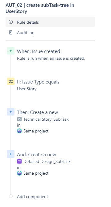

My example:
Atuomation rule should run and do something (doesn´t matter what) when a UserStory is created.
So the trigger is "create issue" with condition "issue type equals UserStory".
Now this rule gets activated and counted as a run of an automation rule EVERY TIME an issue (no matter which issue type) is created.
imho the condition "issue type" only makes half sense....
...and I swear there was no activation when I left into my vacation 2 weeks ago :o

HI @Stefan Salzl -- Welcome to the Atlassian Community!
Would you please post an image of your rule?
It seems from what you are describing that the rule is firing because the trigger occurs and then the condition stops processing. Providing the image will help the community give you more information and advice.

How could it be the other way round?? As I understood the condition refers to the trigger so the rule only fires when the event matches the trigger and its condition.
The rule fires based on the trigger - regardless of the Condition. Whether it does anything or not after it fires depends on the Condition. But it has still fired.
