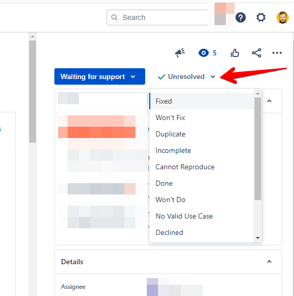

Hello! have exactly the same issue!
for some reason I have TWO Resolution statuses in my tickets.
they are Unresolved and "Unresolved".
for example it is looking like this in JIRA card view. seems like all is fine
and i do not have any additional Unresolved Resolutions in my JIRA admin panel. except one that always been there.
so seems like all is fine too.
admin - View Resolutions page:
but still i see TWO resolution filed values when I try to filter by it:
and some of my tickets are being falling off from boards because they had assigned incorrect "Unresolved" resolution instead of Unresolved
I hope this will help.
looking forward for your replies!

Hello @Vitaliy Denchyk you need to remove the Unresolved resolution listed on the resolutions page.
Unresolved is what jira uses to identify that an issue doesn't have a resolution as such (it would be as the value of the field is empty). In this case, the Unresolved you have listed there is a valid resolution option that jira will consider the issue as resolved for all the reports and metrics. Jira doesn't check the name of the option to mark the issue as solved, it would be "just coincidence" that is named the same way than the "lack of value" option I mentioned before.
I hope that clarifies this good enough
