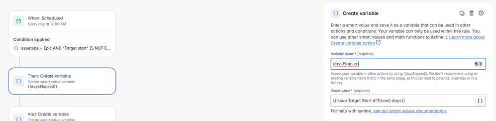

In a scheduled automation, I am trying to calculate the difference between the current day and the Target Start day.  The automation runs successfully, but the variable that I am trying to put the value into is blank.  Any suggestions?  Here is the Smart Value I am using:
{{issue.Target Start.diff(now)}}
I have confirmed that I can move both values (issue.Target Start and now) into variables successfully.  I've also tried to use those variables as a work around but no luck there.
Any ideas are greatly appreciated!

Can you please provide screen images showing the entire automation rule?
What is the field type for Target Start? Is it a Date field, Date/Time field, or something else?
One thing that I notice is that you did not specify the unit for output. Do you want weeks, days, hours, ...?

Kevin Wujcik
July 16, 2025
I'm looking for the field definition for Target Start, but it is the default field type used by Advanced Roadmaps.
Good catch on the unit. I updated accordingly and unfortunately still no luck there ({{issue.Target Start.diff(now).days}}).  Same results.
Does this give you what you were looking for?

I found the answer here:
https://confluence.atlassian.com/automationkb/how-to-use-smart-values-in-automation-rules-to-compare-the-the-target-start-and-target-end-date-fields-1115156802.html
Though that article says it is applicable to Data Center the same solution works for Cloud.
Try this:
{{issue.Target Start.toDate("yyyy-MM-dd").diff(now)}}
I tried that in my own system and it worked.
Also make sure that "Target Start" is the proper name for the field. In my system it is "Target start" with a lower case "s". Automation rule references to field names can be case sensitive.

Kevin Wujcik
July 16, 2025
Looks like that was it!  Thank you so much for your help!

Bill Sheboy
July 16, 2025
Hi @Kevin Wujcik -- Welcome to the Atlassian Community!
The built-in Target Start and Target End fields' values provided to rules are text representing a date value.  They cannot be used with the diff() function until they are converted with toDate:
https://support.atlassian.com/cloud-automation/docs/examples-of-using-smart-values-with-dates/#Converting-text-to-dates
For example:
{{issue.Target start.toDate.diff(now).days}}
(Although you may want to reverse the values if the target is in the future.)
And if you want to set the value of the target fields, I believe that must be done using a JSON expression.
