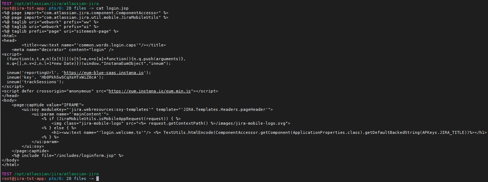

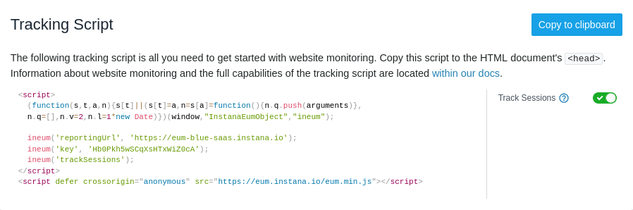

This is the guide directly from Instana:
Tracking_script_Instana_jira.pngI Tried to update login.jsp with above script but so success. Nothing is visible in Instana. Even when I try to see source code in browser I can't see my updates there.
Elsewhere I found that not reflected changes might be cause by caching and there was recommended to comment out below login.jsp lines in web.xml to make changes visible. I restarted Jira few times but still no success.
Note: There is one more file called login.jsp in folder decorators and I didn't touch that one so far.
