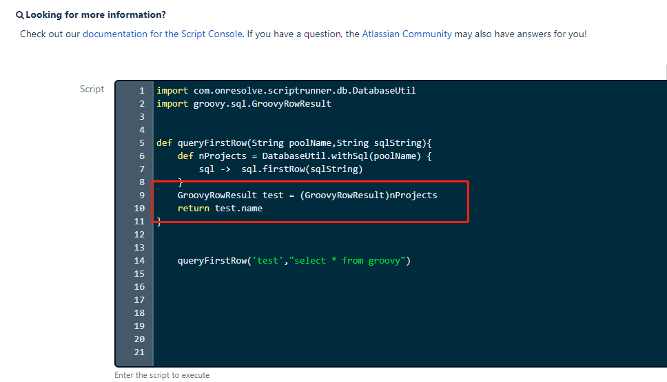

Hello everyone, I executed a script in the script runner, and the result is correct, but the code ha

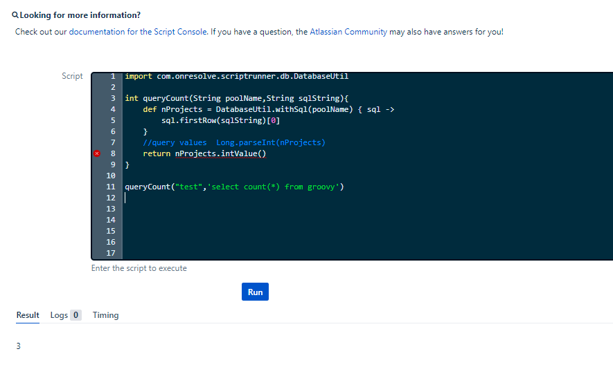

Hi Haiyaner,
Thank you for your question.
I can confirm that the red cross which you are seeing is the result of the Static Type Checking feature in the code editor.
I can confirm that you can read more about this feature inside of the ScriptRunner for Jira Server documentation page located here.
As noted in the documentation, unfortunately, there are some limitations with the type checker which means it's possible to write code which displays errors when in fact there are no errors.
This means that if you go ahead and execute the script it should work as expected.

haiyaner September 1, 2019
Thank you for your answer. I did not use def to define the variable, but specified the type of the variable, and then ran it successfullyjira4.png
