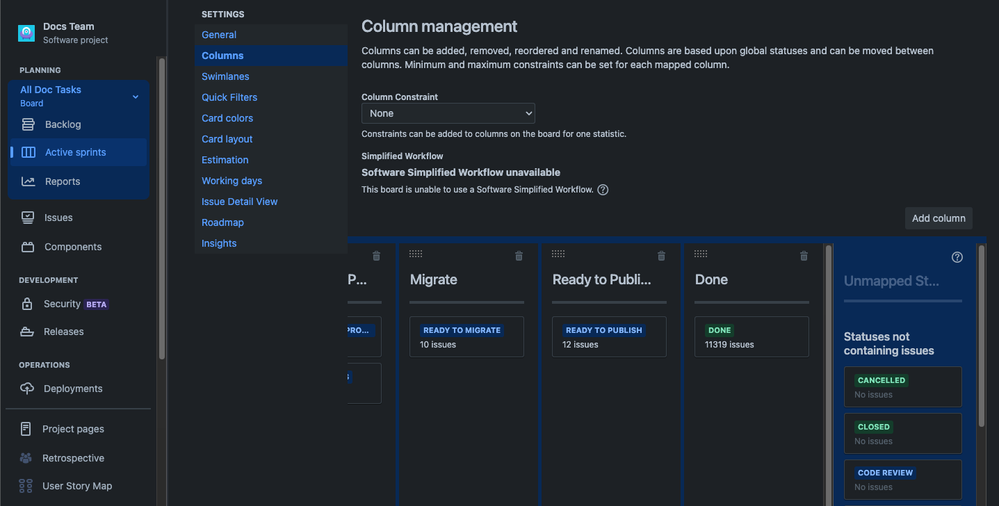

Done issues with Resolution set in active sprint backlog:
Board settings showing Done status mapped to far-right column:

I've added a couple screenshots to my post to illustrate what I'm seeing.
