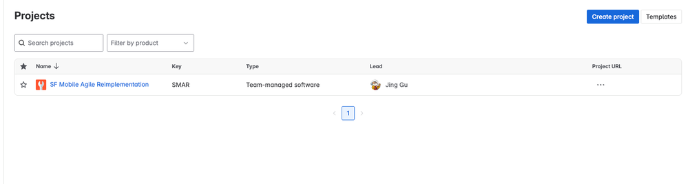

Given that the project is of type "Team Managed Software"

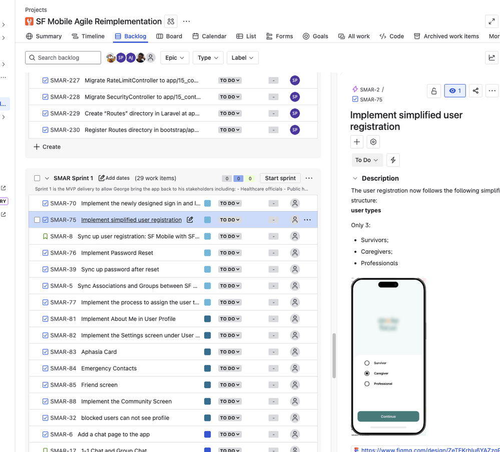

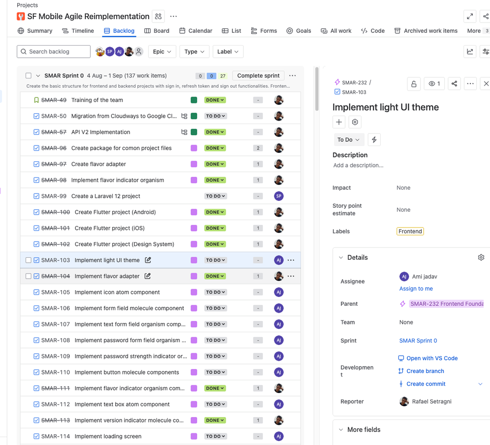

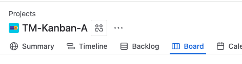

1. Navigate to the project (click the project link shown in your image)
2. Check if you see a Board tab in the display. Check if you also have a Backlog tab.

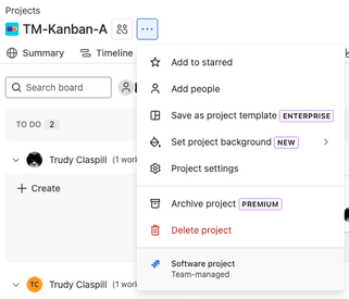

3. Board should be present already. But if it isn't then click on the ... button next to the project name and select Project Settings.

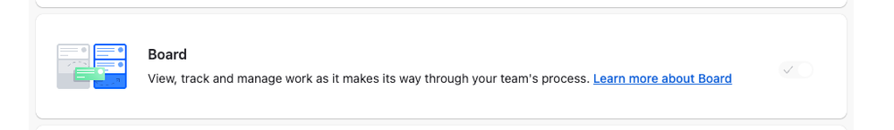

5. On the right you'll see features that can be enabled and disabled for your project. Board should be enabled with no option to disable it. But if it is not enabled, enable it.

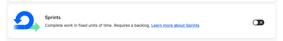

6. If you want a Kanban style board, not a Scrum board, scroll down and make sure that Sprints is disabled.
