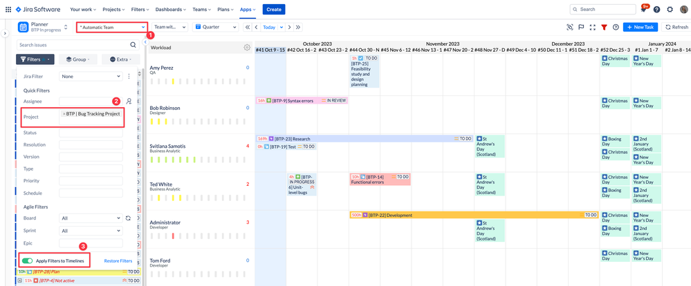

Any suggestions for the following...we need to see multiple projects and their ticket timelines...we are using Activity Timeline plugin and can see by resource, but need to see by Project as well...any ideas?

ActivityTimeline is really built to help you look at things from a resource or team member's perspective. That means we don't have a standard Gantt chart view focused on projects.
Nevertheless, you can still visualize one or multiple projects and their ticket timelines through a user-based lens by leveraging our project filters on the timeline panel. Additionally, by using an 'automatic team', the system will group together users involved in the same project, giving you a more project-focused view within the existing framework.
This way, you can simultaneously assess resource allocation and project timelines to make more informed decisions.

Thank you for your reply.  The issue is that it groups the projects vs. doing a line per ticket in the project...even if I search for a specific ticket, the right side of the screen does not update.  Do you happen to do webx calls so we can share our screen and show what's happening vs. what we need?
