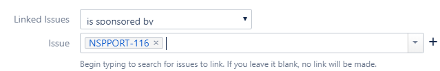

OK, here's the situation:
My stories have a link that is "Linked Issues" and the selection is "is sponsored by" and then we link to the portfolio epic that funds that story.
I need to update many stories with that information, but I don't know how to do it via a bulk change instead of going one-by-one.  This is not a field available.
Anyone can shed some light here?

IDSJR June 11, 2019
Hey Petterson,
Thanks for your attention to this.
The JQL I currently use to see all the issues related to a particular Portfolio is the childIssuesOf(""). Example:
id in childIssuesOf("NSPPORT-xxx")
That returns all issues under that specific NSPPORT.
The problem that I'm having is that just recently we started to use the link "is sponsored by" and there're a lot of active issues that need to have this information updated, but I don't see it as an available field to perform a bulk update.  Is this even possible to be done as a Bulk change?

Thank you for your explanation. Now I understand that the parameter you would like to change in the bulk operation is the linked type and linked issues of the ones returned in the JQL query.
Unfortunately, JIRA does not have this kind of functionality in the bulk operation feature. We have a feature request opened to implement it:
Bulk Link
Feel free to vote and watch the suggestion to increase its priority and also receive notifications about any updates.
