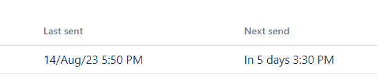

i tried this , but its saying next run on 3.30PM .
our time zone of instance is different , so i think it wont work as the requirement .
i'm attaching my instance time zone and filter sub scription, please find and let me know if any changes need to be done .
@CHINNAMUTHEVISAI.SATYANARAYANASHARMA, update hours according to the system time then:
0 */5 22-22 ? * FRI-SUN
The system time is used for subscriptions.
