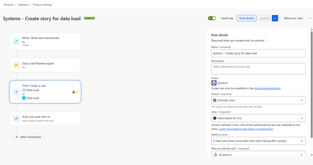

Automation overall screenshot:

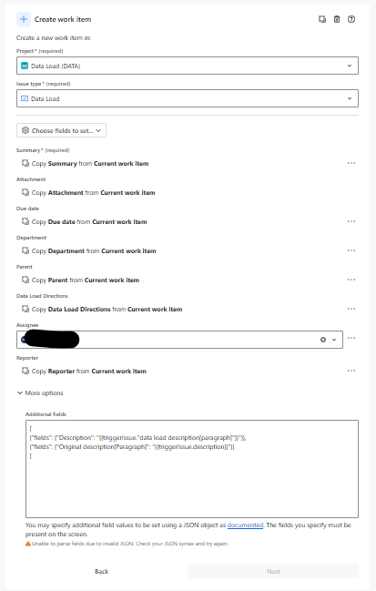

Details of Create new work step:

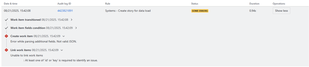

Audit Log:
If I take out the Json part in the additional fields, the automation works fine. That's why I think it's something with that particular part (in addition to the audit log telling me that it's not valid JSON.

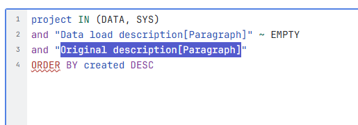

If I try to create a filter with the custom fields I made, here's what shows there for the smart values.
I've tried this with and without the [paragraph] part.  And I copied / pasted this directly into JSON and it still didn't work.  The rest api link didn't work for me today, but I can work with that more tomorrow to double check the the smart value / custom id of the custom fields.

Thanks for that information, @Amy Schindel
In both your original and the JSON shown in the rule images, there are typos / stray curly brackets.  And, please note smart values are name, spacing, and case-sensitive.  This is why I suggested using that how-to documentation confirm them.
Here is a cleaned up version that may work if the the smart values are correct:
"fields": {
"description": "{{triggerIssue.data load description}}",
"Original description[Paragraph]": "{{triggerIssue.description}}"
I suspect that "data load description" is not the correct smart value for the field.  Perhaps try using the custom field ID instead, which can also be found with that how-to.
