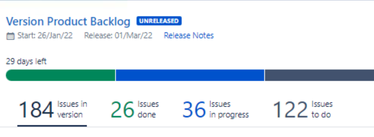

We have create one fix version and associated 184 issue in the version then while my seeing in the backlog page its showing only 176 issues.
why this difference in this version alone but other fixversion is coming properly.

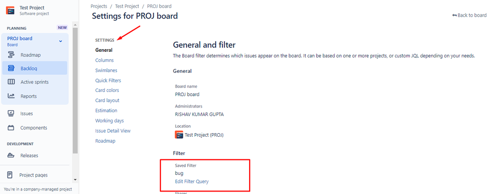

Hi @Rajesh Ramankutty It is because of the board setting . it will show correctly in the version section that how many issue are how many issue are there but in board setting if you use diff filter it will reflect in the backlog part .thanks!!

Hi Filter Query for the board is only having project name
Well these two views could be different thing.
Did you check the board filter where you see the backlog if that filter has been configured for the same backlog version ? Or if the filter is changed to exclude few issues ?
Vishwas
hi that version if i checked in jql its showing 186 issue but in backlog its showing as only 177
Try adding the same JQL which showed 186 issues to the board.
From the screenshot above i could see that query was just picking project name.
So create a new filter for that version and attach to board and see if that woks.

This issue is resolved it showing correct number of issue once i changed the filter
Thank you
Fantastic, like I mentioned previously it was filter issue.
