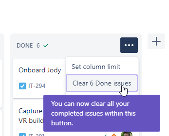

Just noticed this today!
That is only in Next-Gen Projects this does not work in Class with a Kanban .
