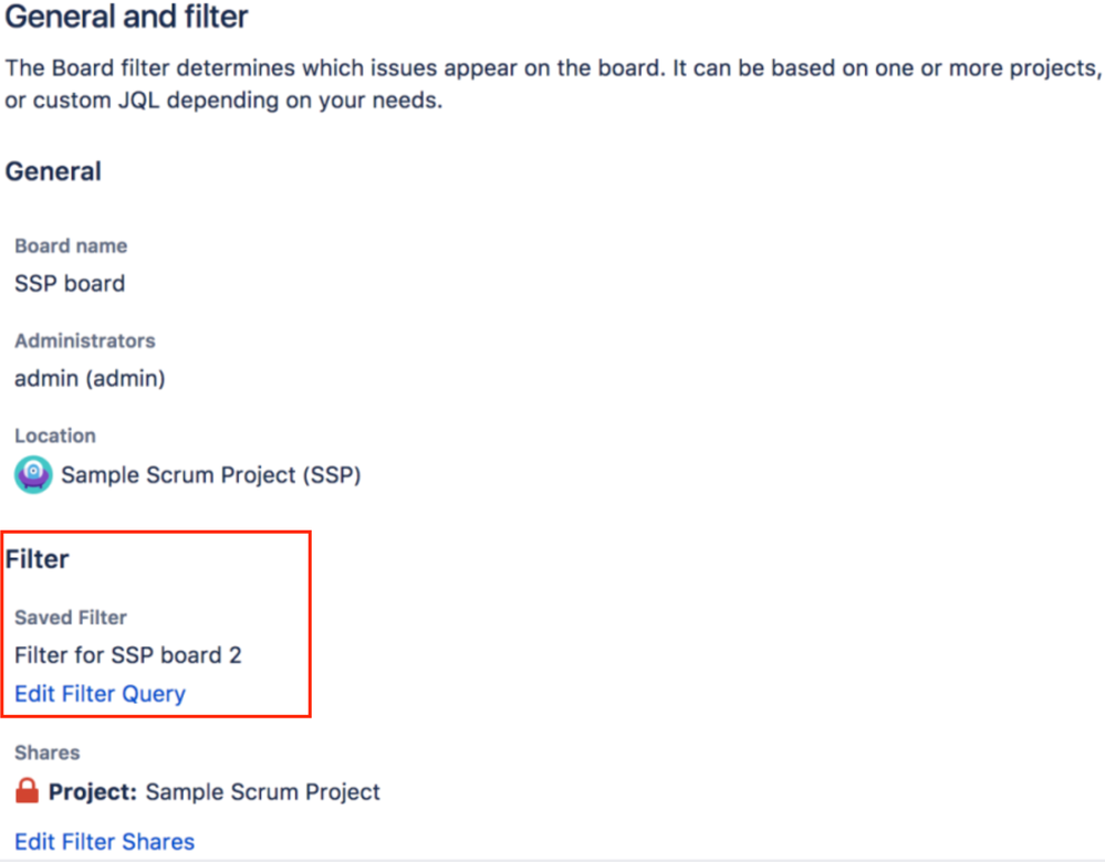

Can you confirm that I make this change by being in the SCRUM board >> Board>>Configure>> ??
Not sure from that point onwards though!
Any help would be greatly appreciated
Yes, in that configure menu you should be able to view the underlying filter query and the name of the filter being used.  From there you should be able to edit the filter in the issue navigator and save it.
