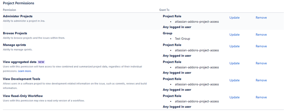

You can drop a screenshot of the permission scheme here if this doesn't work.

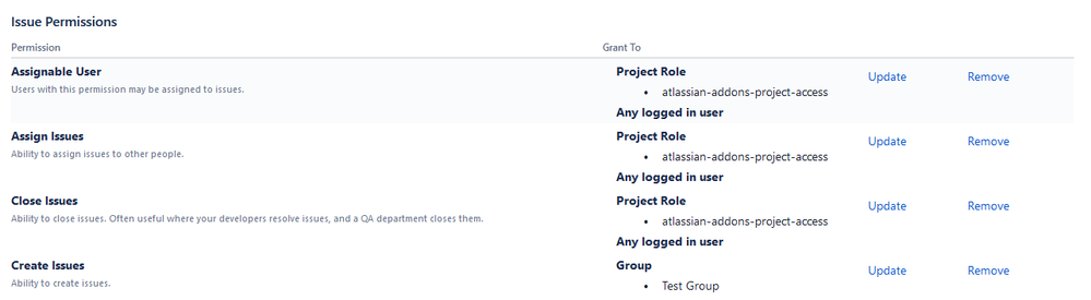

Hi Elvir,
Thank you and appreciate for taking the time to response to my query. Tried your suggestion but user can still see all the project lists but cannot browse to it. As requested, please refer to the screenshot below.
Let's try to remove "any logged in user" from the View aggregated data permission
Hi Elvir, tried your suggestion but user can still see all the project lists.
I just noticed that you also got any logged in user in administer projects.
This doesn't seem like a good practice. Only users with project roles / group administrator should get that permission.
Also, is this permission scheme applied to all the affected projects ?
Hi Elvir, yeah this is only in a test projects but thank you for pointing that one that this is not a good practice I'll keep this in mind. Actually, tried again your suggestion but the user could still see all the projects.
