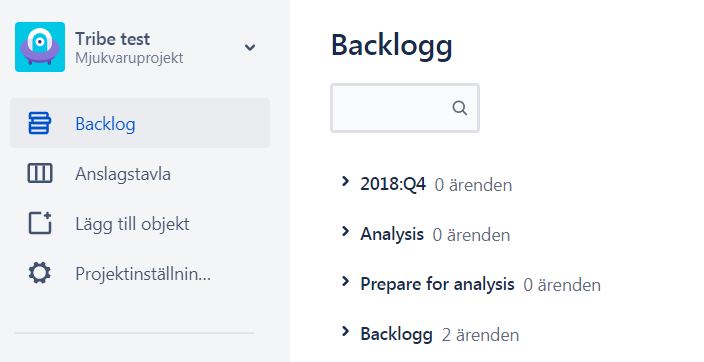

In Jira cloud, it looks like it works just fine if I select to create a scrum project (non traditional). I created several sprints to manage the status/progress in the process:
You should be able to add several statuses in the backlog as shown in the following screenshot:

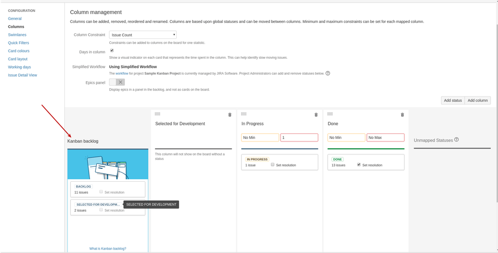

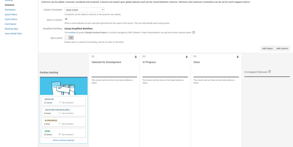

Hi @joesoes,
Can you clarify the Jira version you are using? I have tested this in Jira 7.8 and it works fine without issues:
As you can see in my case, I have added all 4 statuses to the backlog.

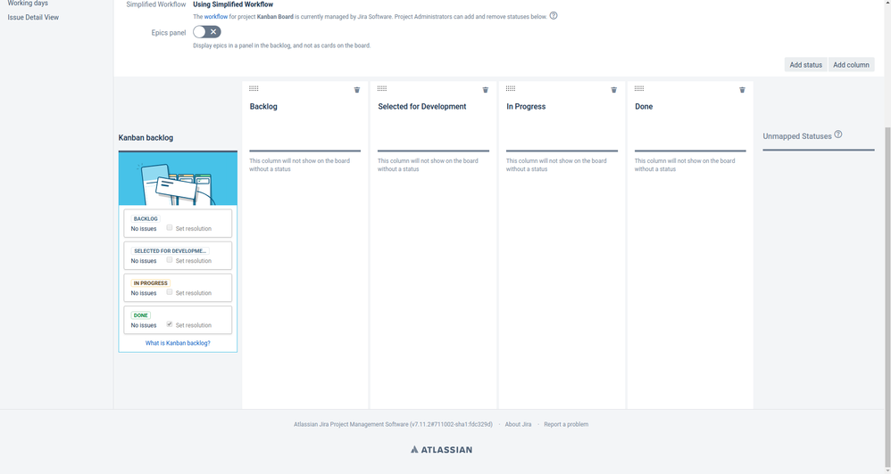

Thanks @joesoes. I have updated the screenshot.
I have also tested this on v7.11.2 and am able to configure this as shown below:
Is it possible that you may a screenshot of what you are currently seeing so that we may have a better idea? You may blur out any sensitive data that may be present.
In addition to this, can you please run the following query on the Jira database:
SELECT * FROM pluginstate where pluginenabled='false';
If you do see any results, this may be that certain modules are disabled in Jira. We are specifically looking for modules with Atlassian or greenhopper.
Thanks. But I don't think that you will get four statuses in the backlog view. Only "Backlog" and "In progress".
