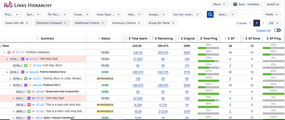

Amay Purohit_RVS
April 12, 2024
Hi @Glenn Andreas
Welcome to the community !!
In Jira with premium subscription, you can create heirarchies above Epic. If you need to add levels below Epics, you can use issue links and create your own custom hierarchy. However to view this in a tree/hierarchy view you would need an app. There are many available in the mktplace. We have also built one on the same use case.
Issue Hierarchy
The app shows your hierarchy in a tree format and  also provides sum up at each level for time estimates and story points to track your project progress.
We have multiple filter options and also ability to use jql for child issues as well. Do try it out.
(Disclaimer: I work on RVS, the vendor for this app)
