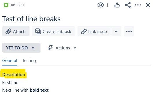

Sunny Ape
May 8, 2023 edited
"I am using API version 2"
Well, that explains it. You are reading the wrong documentation for the wrong product.
ADF support is a feature of the v3 REST API of Jira CLOUD ONLY, not the v2 REST APIs of Jira SERVER or Jira DATA CENTER, which I assume you are using.
For all the v2 endpoints for any Jira platform type, the content of Description field is plain text with optional Wiki markup. Put markup formatted plain text into your JSON description object, and that's what will be rendered in the Description field.:
"project": {"key": "BPT"},
"issuetype": {"name": "Story"},
"summary": "Test of line breaks",
"description": "First line\nNext line with *bold text*"
Will result in the issue:
