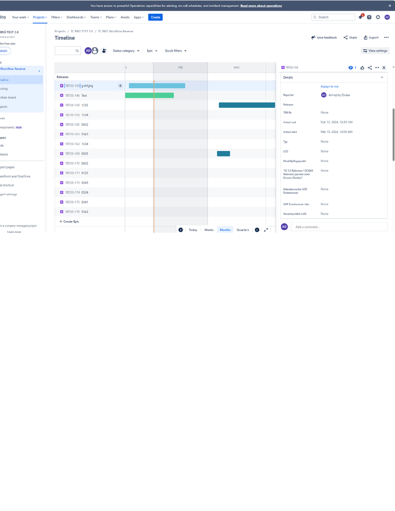

Hey I thought the beam of each issue in timeline is affected by the JIRA Field: "Actual Start" and "Actual End" however as you can see on the picture the beam has a different time span than my given Start and End date. Which field is connected to the time beam or is there even any?

the timeline bar is based off of "Start date" and "Due date". Can you assess your issues based upon this info to confirm it is correct? For your reading pleasure - add-issues-to-epics-on-the-roadmap
