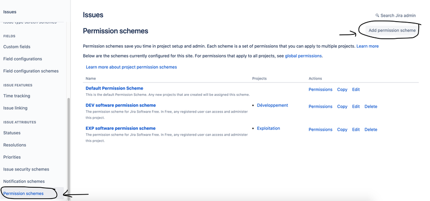

For what you want to do, you need to do two things. In my opinion, you can do as follows.

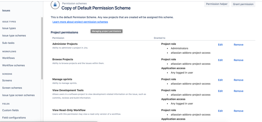

First, you need to create a permission scheme. A permission scheme is linked to a project. It allows you to control who can do what in that project. I suggest you create one for each of your project. You can copy paste the default one and make one for each project. You can also make the same for everybody. Don't worry : it does not imply that everybody will have the same rights on every project even though the same permission scheme is on every project.
For that, we will use Roles to manage your permissions. You can say for example that if somebody is in the Developer Role for project A, he/she can browse it and see it. If he is not, he won't see anything.
Let's say we have Albert, which is part of project A. I set my permission scheme so that only people in the Developer Role can see the project and work on it. Then, i switch the current permission scheme of project A to associate my brand new permission scheme.
After it, i go to project settings in Project A. I go to the People tab and add Albert in Developer Role. Albert is now able to work on project A.
Note that Roles are independent for every project. That means that, in my previous example, given that I set a similar permission scheme for project B and C, Albert won't see anything from project B and C because I did not add him in any role for that projects.
I let you try for the configuration of the permission scheme. Don't hesitate to tell me if you still need help.
