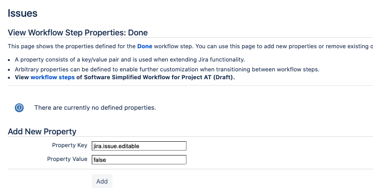

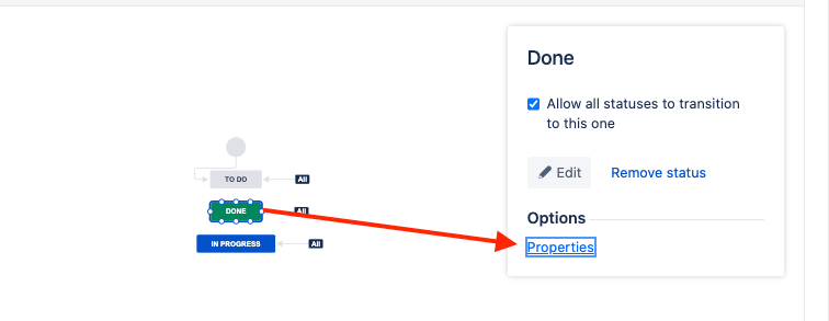

If you want block editing of fields in an issue when it is in a particular status, you can do that by modifying the workflow that affects those issues. This will work for a Classic project. I don't know about Next Gen projects because I don't work with those.
For all issues to which this workflow applies, the issues in the specified Status will now be read-only. Note that this does not prevent changing the issue from the Status to another Status, and it does not block entering Comments on the issue. It prevents changing fields, like Summary, Description, Components, and so on. This will take effect immediately on all issues in that Status that are subject to the workflow. You may have to modify multiple workflows, if you have different workflows for different types of issues, or different workflows for different Projects.
This works for Classic projects. I don't work with Next Gen projects so I don't know what the process would be there.
