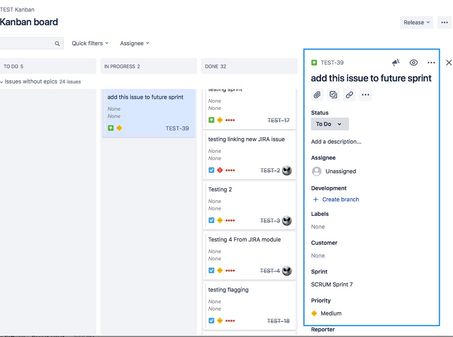

How can I change the layout of the Issue Detail Screen?
JD Lobue
August 18, 2018
We currently have way too many fields in the Issue detail screen that we do not use. How can I remove/hide fields and move some higher priority more used fields up to the top and others to the bottom. We are using the cloud based version if that matters. Thanks

Thanks for your reply. When I go into the configure screen, I see a bunch of fields that allow me to remove and move. Yet my issue detail screen doesn't seem to be updating based on those changes.

The "issue detail" screen is usually the "view" screen, but I'm guessing you are talking about one of the board view screens, which are less customisable.  They'll respect the fields you remove from "view", but have a fixed order that you can't do much with.  You can try Board -> Board Configuration -> Issue, but might not be able to do a lot with it.

I think you're right. The view screen. I can't see how to configure the view screen. Any ideas? It's not in the board config

You cannot configure the ordering of issue detail screen as shown below. as Nic mentioned if the fields are removed from the view screen they should disappear from the "issue detail" view.
