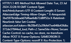

Hello! I am using this URL: 'https://honeywell.atlassian.net/rest/api/2/issue/' to create issues by passing data in JSON format.
The method used to work before we migrated from on-prem to cloud. However when I try to do the same in the cloud instance I am getting the following error:
Using Basic authorization

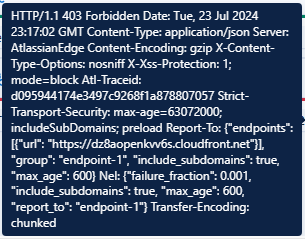

Alternatively, I tried the API Token using Bearer authorization but I'm getting this error:
Any help much appreciated!

On step 2, I am using Content-Type:application/json as you mentioned and email:password Authorization base64 encoded. The reply is HTTP 405 Method not allowed.
Since that didn't work, I tried the API Token via Bearer Authorization but it gives
"Failed to parse Connect Session Auth Token"
So both steps have been tried without success. Not sure if this might be because it's a new Jira Cloud instance...
