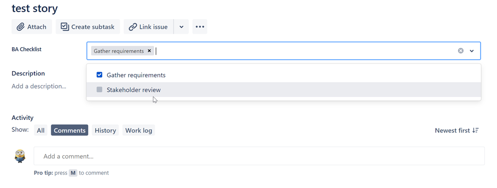

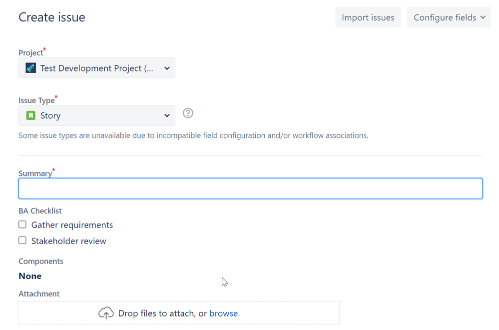

@amara_welling you can add (as @Trudy Claspill suggested) Custom Field called BA Checklist (type checkbox) and populate its options with your checklist (Gather requirements, Stakeholder review, etc). Then you can add such field in issue screens. Probably you can also create condition to your workflow transition to Done status for story that will not allow anybody to complete the story without all options checked.
Field configuration:
Issue creation screen:
Issue view screen:

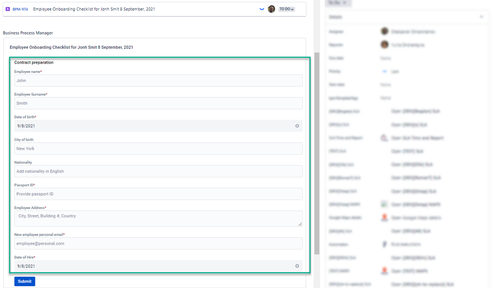

You can also consider Business Process Manager. Using it, you can do what you need: in a specific issue, there will always be a form that you as an administrator can configure and which can start at any time.
Moreover, results from a form can be automatically written as an issue custom field, and you can use it for JQL queries.
If you need help with configuration, let me know (this app is developed by my team).
