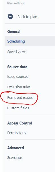

On the right of the name of plan there is a "..." if you move tre cursor on it yo can seed a label "Plan settings" if you click on it appear a menu:
If you click on "Configure" you can see on the left this:
Here I find all "Object" that I remove from my Plan.
I need to know if it is possible to exclude this list from the query.

The Removed Issues is an internal feature of Advanced Roadmap and it is not exposed externally, so it cannot be identified or accessed outside the plan. This means there is no way to filter the removed issues in a JQL query.
I hope this answered your question.
