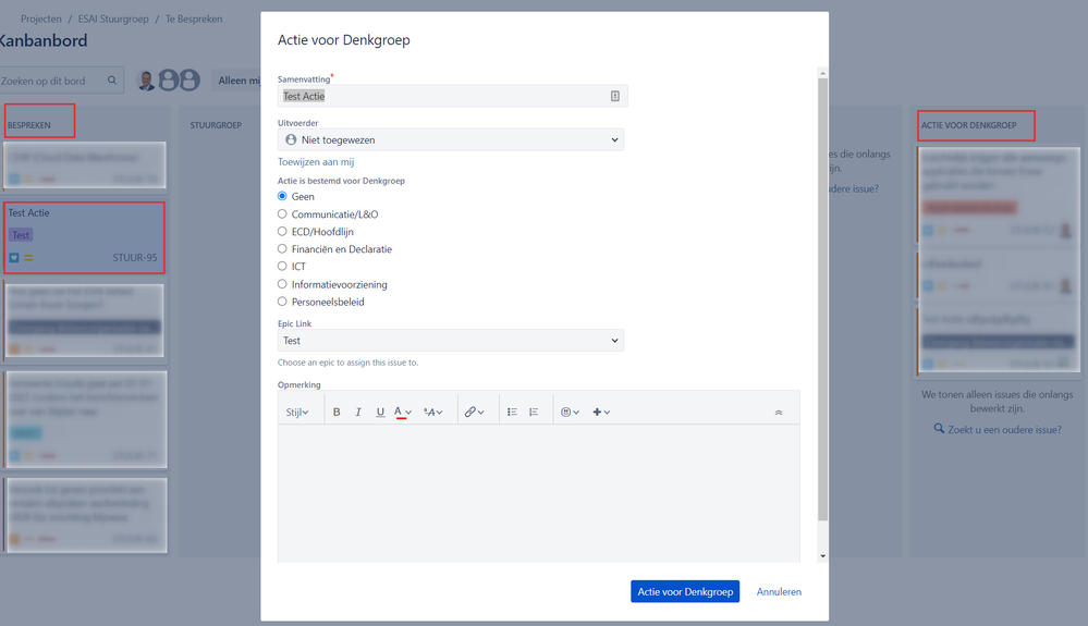

Step 1: When moving the test issue column "bespreken" to column "Actie voor Denkgroep" then the transition schema pops up.

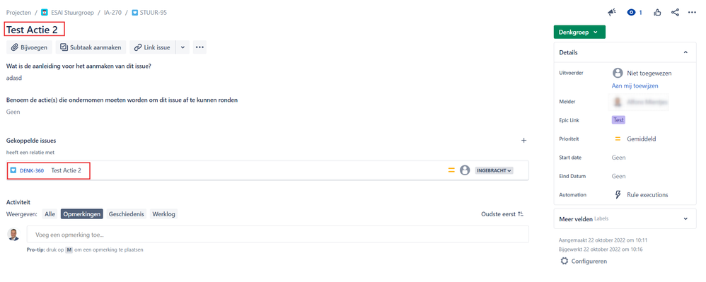

Step 2: When I edit the summary and description in the transition schema, I want those values to be copied into the newly created issue and not that the summary and description are overwritten within the source issue. se screenshot below. The new issue is created and linked. That's OK.

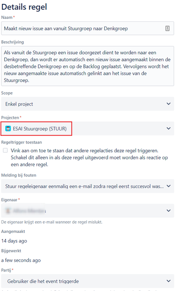

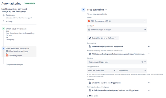

Automation rules settings:
You are very close to achieving what you need. The issue is that the transitions screens affect the current issue, so you need to create new dummy custom fields. One called new summary and new description. Then using the smart values you need to copy {{trigger issue.customfield_xxx}} into the create rule to replace the summary and description accordingly.
This way the original issue doesn't change.

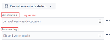

The Summary and Description fields are system fields. I can still deselect the description field, but he really needs the summary field. That is required. It seems that there is little point in making a dummy for that.

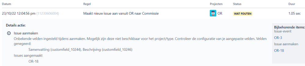

In addition, the creation screen of the new issue does not use those dummy fields that I use in the transition schema. Then it gives the following error message.

@Take a look at this video on how you can create and link projects at creation. You just need to changed it to a transition trigger. Link: https://youtu.be/5Xs8cnDIFB
Regarding the transition schema, no need to add the to you issue schema. Ensure that both projects have access to the context so that they can be called.
Then in the create rule you select the summary field and put the smart value {{triggerIssue.customfield_newsummarycustomfied_number}}
For the description field {{triggerIssue.customfielf_newdescriptioncustomfield_number}}
