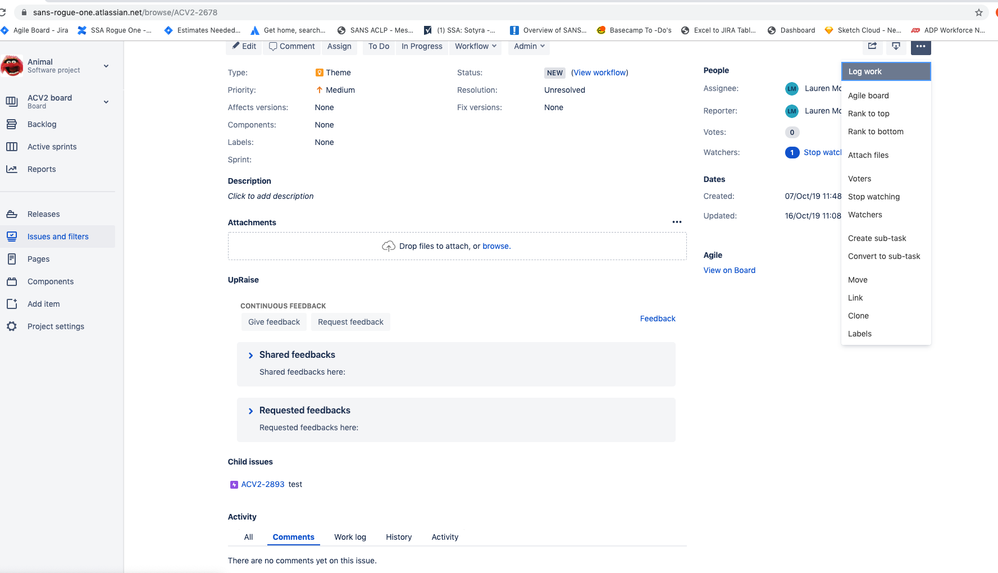

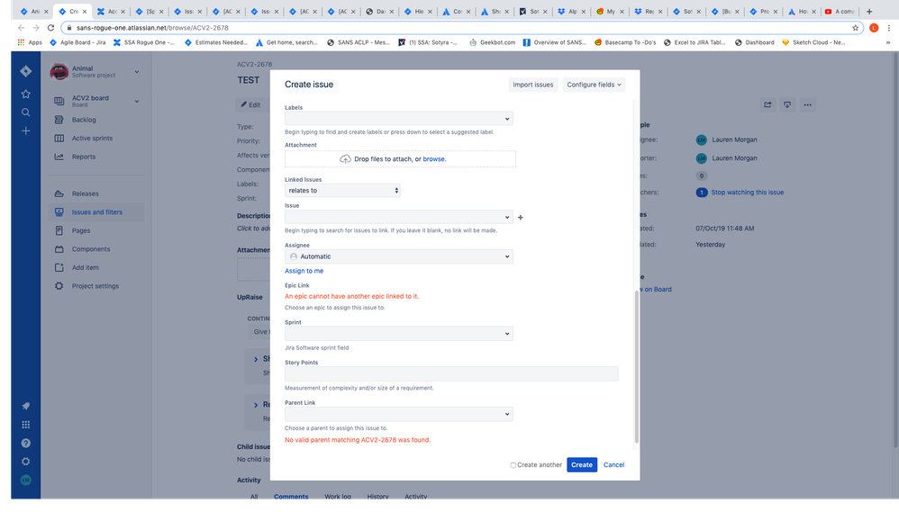

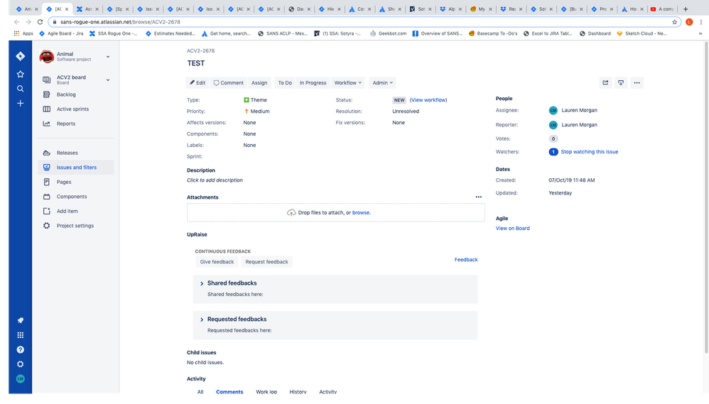

Thank you for your response! I was told we have Jira Portfolio. Here are screen shots of the Theme we have in place. Then another screenshot where I am not able to create an epic and parent link it to the the them (it says it doesn't exist). There is no option to create an epic within this Theme either. So I created one from the regular "+" create button and tried to link it as you stated with the Parent link field but that doesn't' seem to work either. The only success I've had is to link epics that are already created and move them to this theme but that doesn't help us much if we want to create new epics under this Theme. It seems far too complicated for a very normal function in Jira so I'm not sure what the issue could be?

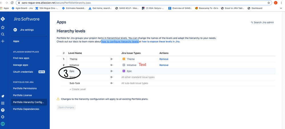

Indeed, this is a weird problem and the link between both hierarchy levels should not be that difficult. In fact, it seems that JIRA is not recognizing the Theme/Initiative as a higher hierarchy issue type than Epics.
Could you please confirm if the Theme and Initiative issue types were configured with the proper category as mentioned in the section "How to switch the hierarchy level view" of this documentation?
Basically, perform the two steps below to ensure the correct hierarchy of the issue types:

Is the fact that Epics not set causing issues perhaps? See Screen shot!
Hello Lauren,
Per your screenshot, it seems the Epic is being considered at the same level as standard-issue types for Portfolio.
Could you please set the Epic with level 2 and map both Theme and Initiative at the same level (Level 1)? I believe it would fix the problem.

Thanks so much for your reply once again. We have made your change as recommended. Luckily I am able to create an epic and add this Theme parent to it, but still don't seem to be able to create an epic within the Theme. Is that just not possible? It seems strange because in other places where I've worked you could create Epics within an Initiative with no problem. I assumed the same would be true for Themes, no?
See screen shots attached.
