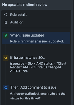

Im trying to create an automation rule to add a comment when a specific status (client review) has not been updated after 72 hours.

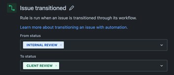

This is what I have at the moment, but I'm sure it's the trigger where I'm having the error, but I don't know which one is the most appropriate for my situation.
I used the Issue transitioned trigger, however, when using this it does not respect the rule that the status has not been changed after 72 hours. It only adds the comment immediately it changes from one status to another.
Finally, I want to know how to configure the Then, so that in the comment the rule tags the person who created the ticket. Right now I have it as @{{reporter.displayName}}, but I want the person to be tagged.
THANKS!

Hey Tessa, thanks. I have a question:
If I schedule it every day, will this message be repeated daily on tickets that are not updated? If yes, how can I avoid this? Because what I want is to send an alert message only once, but not for it to become daily if there are no changes.
Also, would the query be like this: issuetype = Story AND status = "Client Review" AND NOT status changed after -72h
