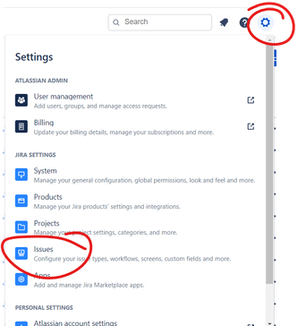

I dont see any of the details you are sharing on the top right corner. This is the only view I have.
Alex Koxaras -Relational-
September 6, 2021
The cog is right next to your avater (PF). Between the question mark and your green avatar :)

still, I cant find there where the "issues" are. When clicking on the cog, I only get the options from the screenshot attached.
September 7, 2021
@Patricia Ferrari if you can't see the option like the image below:
Then most likely you have to contact a jira administrator to do this work for you.
