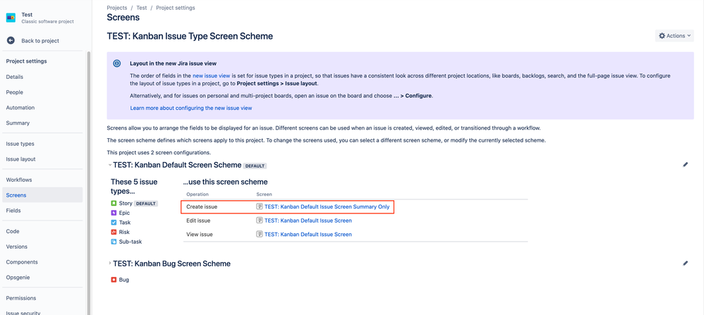

You can fix this by going to Project Settings -> Screens and dropping down the screen configuration for the issue type in question. You will then want to confirm that the "Create" screen that is selected has the required field on it. See screenshot below that points this out.
You can either add the required field to this screen, or if you'd like you can create a new screen that has all of the required fields and link this new screen to the "Create Issue" operation.
