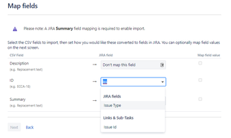

I have tried multiple options. For e.g. mapping column which has key (TEST-2) to 'Issue key' and then mapping column which has parent(story) issue key (TEST-1) to 'parent id' and then uploading. It created 4 new issues and doesn't link them. I was expecting it will not create new issues as issue key already exists. I have tried mapping different csv column to different dropdown options but now luck. Each time it creates either 1 new issue or 3 new issues or 4 new issues.

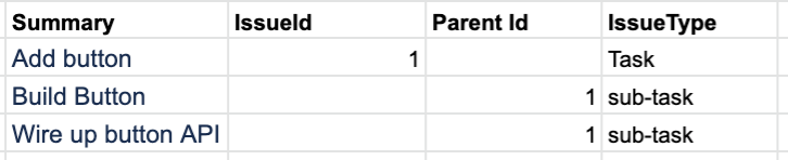

Hi all, i think i am having a similar issue. I would like to import a csv in which I have both the tasks and the sub-tasks listed. Example
Task - Add button
Sub-task 1 - Build Button
Sub-task 2 - Wire up button API
How, in a single sheet do i make Sub-task 1 and sub-task 2 sub-tasks of the Task WHERE the Task does not exist before the import ?
Thanks in advance

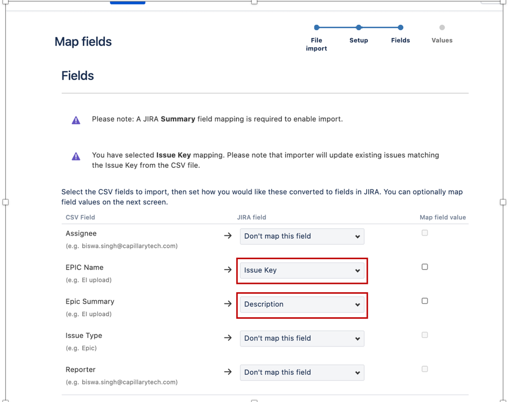

Hi, I have a follow up question which i cannot seem to find an answer too on Google
The BA i am working with users another program to update her tickets. Each week i get a report of these updates and have to manually find and replace the Description field for many tickets.
Is there a way in Jira to "import" these in a single bulk move ?
I have looked at Bulk Change, but this dose not allow it ( assume as different for each anyway) and Bulk Import does not allow me to associated the key, hence i assume does not allow it - unless i am missing something.
Does anyone know if this is possible and if so how to achieve this ?
Both "Issue Key" and "Description" are part of bulk import, so you can use them for your requirement.
Issue key shall be used for already created issue on Jira. You can map description to it, whenever it changes.
Thank you fro your reply Prateek. Unfortunately i do not see that option.
I am using the cloud instance and am administrator will all admin rights
Is there something i am missing ?
Thanks in advance
Hi Prateek
Please ignore the above, i have discovered that if you go Cog > User Management > Jira > External System Import that the options are different AND the issue key is available.
Thanks again for your help
Yes Neil. That’s an existing behaviour. Options differ for import when you access it from different locations. Jira should have had set this based on user access and not the location from where it is accessed.
Also, there are some bugs when you do import from normal import issue screen. So avoid that.🙂
