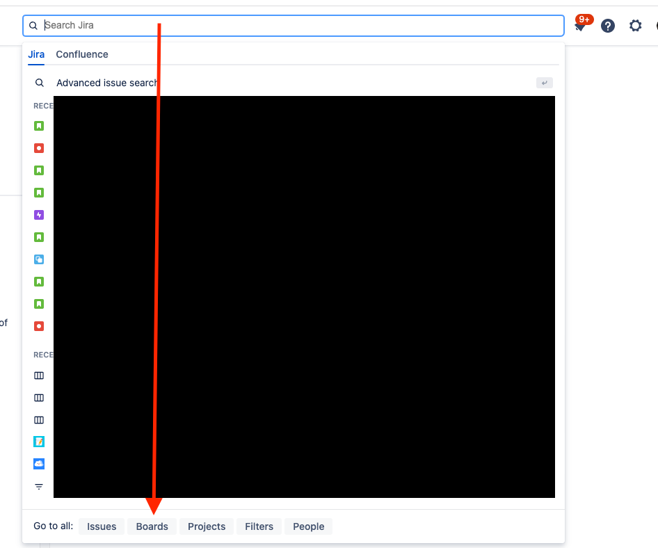

Have you looked for the board in the list of all boards?
Click in the Search field next to your avatar, and then click on Boards at the bottom of the pop-up. This should take you to a complete list of boards.
If you can find the board there, you should be able to delete it by clicking on the three dots to the right and selecting Delete.

Thanks, that worked.
