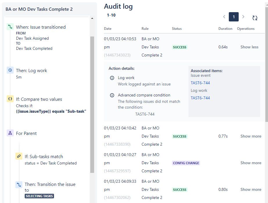

I have a rule to transition a parent issue when all the sub-tasks are completed.  It works with one sub-task/Issue Type/workflow: {{issue.issueType.name}} equals "Dev Task".
I created a second sub-task Issue Type, but when I tried to add it to the compare using {{issue.issueType.name}} equals "Dev Task" "Software Move Issue Type", the automation log shows: "The following issues did not match the condition:" and the sub-task issue key.
Is it possible to use Compare to include multiple Issue Types?

I changed the first Compare to {{issue.issueType}} and Sub-task, but it apparently isn't working.  Since there are two issue types, if I go back to {{issue.issueType.name, I don't know whether or how the rule can be changed so that it looks at both.
Then I changed the Compare to {{issue.issueType.name}} and "Dev Task" "Software Move Issue Type", but got the same result.

2) New rule :
3) New rule log, showing success only because of comment written to log:
Note that the same Advanced compare condition that did not work appears for both sub-tasks, that use different Issue Types and workflows but share the same statuses.  I also get the same result if I don't use quotes around 'Sub-task'.
If there is a solution involving a branch and/or if/else, I keep losing the ability to find if/else.  I'll keep looking, and if I find it again, I'll try to record the hidden path.
3) Log for rule with {{issue.issueType.name}} and both issue type names:

I got the automation to work by removing the first Compare.
