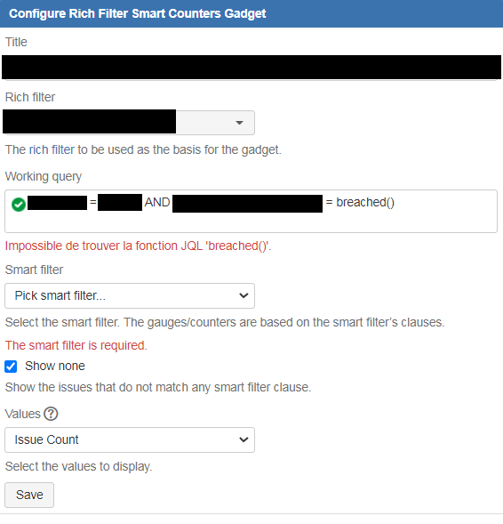

sheikh-spear May 3, 2021

Hey @sheikh-spear
Could you try the JQL on a regular issue search (and not on the gadget)?
It seems that gadget is from an app so it could be they don't support it. If it works on a normal advanced issue search I'd suggest opening up a ticket with them on their portal

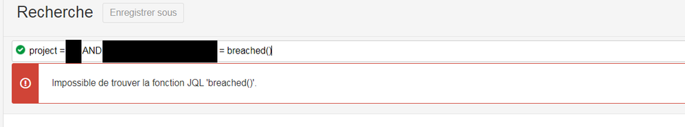

It doesn't work either way

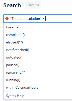

Could you maybe do a type ahead to see what happens? (maybe the language is messing with us)
When I type my SLA's name and then the = mark I'm presented with all the options.
