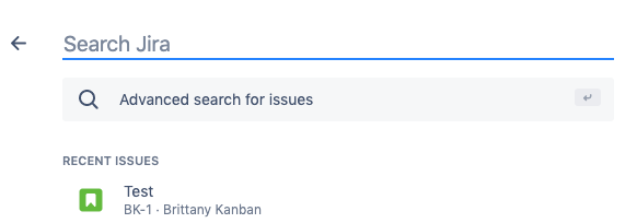

Step 1: Click on the Search icon(magnifying glass)
Step 2: The below will show up you'll want to click on the 'Advanced Search for Issues' option.

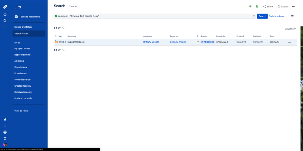

Step 3: You're now in the search for issues section
Step 4: Copy/Paste watcher = currentUser()

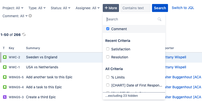

You can always switch back to a basic search to look for anything else that you are needing to report on.
Switching to basic search
Fields easily available
Searching available fields:

Atlassian change this: Between steps 2 & 3 you have to click on "Switch to JQL"
