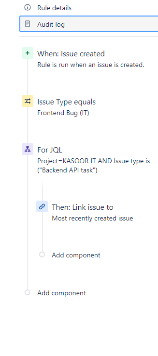

@Trudy Claspill thankls for your response
see thats how I am trying to construct the the rule.I am not sure this logic will fullfill the requirements or no

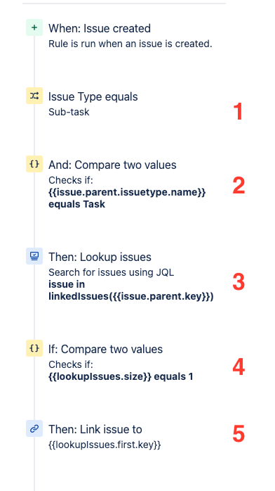

This will work.
At 1, you need to specify the task type you use for Subtasks.
At 2, you need to enter the text that matches the issue type name you use for Front End Task.
At 3, the rule is looking for any issues linked to the subtask's parent.
At 4, the rule is confirming that there is only 1 issue linked to the subtask's parent.
At 5, the rule is linking the subtask to the issue its parent is linked to.
