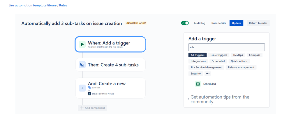

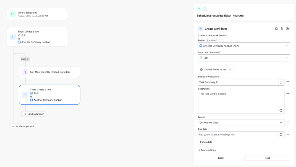

Hi @Lazo Dana Shawkat , welcome to the Atlassian Community and thanks for your post.
I would use a rule like this one - https://www.atlassian.com/software/jira/automation-template-library/rules#/rule/112180 , as a basis to start from.
Basically, you are saying you want a scheduled rule to run, let's say, on the first day of the month to create an Epic and some child Tasks.
You would just need to change the trigger here
Please make a test rule and see if you can get it working. Let us know if you need more help.
Best wishes
Hello @Lazo Dana Shawkat
You mentioned that the tasks have "specific due dates". How are the due dates determined each month? For example, are they relative to the beginning of the month so that one task is due on the 7th day and another on the 13th day?
As @Valerie Knapp you could set up an Automation rule triggered on a Schedule and have it create the Epic and the child issues.
Start with a Scheduled trigger.
Add a Create Work Item step to create the Epic.
Use a Related Issue branch to change the focus of the rule to the newly created Epic.
Within the branch add a Create Work Item step for each Task you need to create.
In each of those steps set the Parent field for the Task to Current Work Item. That will make the Epic the parent of the Task.
You can set many fields when you are creating a work item by selecting the field from the Choose fields to set list and then specifying the value.
When you provide more information on how you would want the Due dates for the Tasks set, we can offer you more advice.

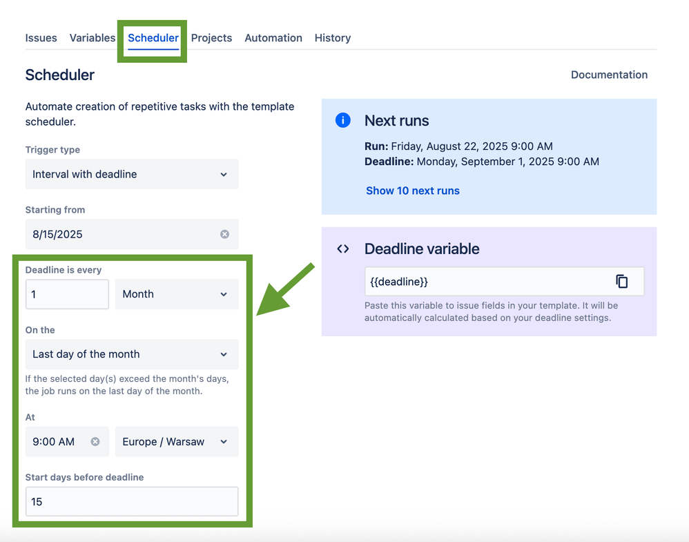

hi, @Lazo Dana Shawkat ! I see that you have a requirement to solve this using Automation for Jira. But, as I understand, you are not quite satisfied with the outcome so far and are looking for a more optimized solution.
If you are open to using third-party apps in the future, I would recommend you try out Smart Templates for Jira (I'm a part of the team that is developing this solution).
Here's how it can help you meet each of your requirements:
- Generating an epic with its 67 tasks
That is really easy compared to the cumbersome Jira automation rules... You just need to create a "model" epic with all the tasks, assignees, descriptions - you can even include subtasks and checklists, basically anything you need. Then, with the help of Smart Templates, you just click "Save the structure as a template".
That's it, you will be able to generate your epic with all 67 tasks from this template anytime, in just a few clicks or automatically. All the contents of the initial epic and its tasks and subtasks will be preserved in the template.
- Creating new epics on a schedule and adjusting the deadline
You can use Smart Templates' native Scheduler to generate this epic with all its tasks and subtasks on a schedule. As I understand, you want it to be created each month on the 15th with the adjustable deadline later the same month. You just need to specify this in the schedule.
Here's how it looks in practice:
You select the trigger type "Interval with deadline" and set the deadline for once a month, on the last day of the month. Then, in the field "Start days before deadline", type "15".
So, according, to this schedule, Smart Templates will generate a new epic with its 67 tasks and all their details from the template roughly on the 15th day of each month (as a month can have 28-31 days, the exact date will vary accordingly). And the deadlines in all 67 tasks will be automatically set to the last day of that month. Obviously, you can also set this up for any other dates, but you get the idea.
I would really recommend you try this out (you can try it for free). It's much easier than using Jira's native automation for this specific case, and it's also simpler and easier to edit a smart template than to change a rule. As an added bonus, using this method doesn't consume your Jira automation limits.
I hope this helps. Let me know if you have any questions!

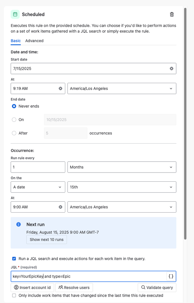

This article talks about a rule to clone an Epic and its child issues, plus a second rule to clone subtasks of the child issues.
This Question talks about cloning just the Epic and child issues. Note that this is an older post and mentions the use of the "Epic Link" field. That field has been deprecated and the "Parent" field should be used instead.
In both of these example they are using a manual trigger, where a user would first navigate to the Epic and then manually trigger the rule. In your case you want to use a Scheduled trigger with a JQL that will select the Epic to be cloned.
In the JQL above replace YourEpicKey with the key of the Epic you want to clone.
Make sure that you uncheck the box below the JQL statement where it says "Only include..."
The other difference is your requirement to set the Due date based on the original issue Due date. I'll explain that in the next step where the new Epic is created.

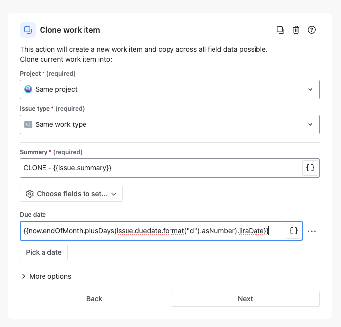

Create the new Epic
Next you would use the Clone action to clone that Epic. In the Epic you would need to set a new Due Date based on the day of month in the original Epic. Here is the step, and I will follow that with an explanation of the smart value I used for the Due date.
{{now.endOfMonth.plusDays(issue.duedate.format("d").asNumber).jiraDate}}
"now" says to start with the current date/time.
Adding .endOfMonth says shift to the last day of the current month.
Adding .plusDays says add a number of days to the last day of the month. The number of days to add is specified in the parentheses.
I'm going to skip over the days to add portion for a moment and come back to it.
Adding .jiraDate says to format the data as a the default format used in Jira Date fields.
Coming back to the "days to add" portion:
issue.duedate says to get the Due date field value from the issue currently in context, which is the Epic selected by the rule trigger.
Adding .format("d") to it says get the day of month from that date.
Adding .asNumber to it says treat the result as a number.
So, let us say that the original Epic Due date is 7/7/2025, and this rule runs on the 15th of July.
issue.duedate.format("d").asNumber will get the value 7.
now.endOfMonth will get the date 7/31/2025 (plus the current time)
.plusDays will add 7 to that date/time giving us 8/7/2025 plus the current time.
.jiraDate will reduce that value to just 8/7/2025, in the format used for Jira Date fields.
Note that some fields in the Epic may not be automatically cloned into the new Epic. After running a test of this rule examine the new Epic to see if all the data you need was copied. If not, in the above step you will need to explicitly select the fields that need to be set and copy the values from the "Current work item"
You can use that same logic within the Branch that clones the child issues of the original Epic, to set the Due date for each newly created child issue.
Let me know if that is enough information for you to develop your solution, or if you have more questions.

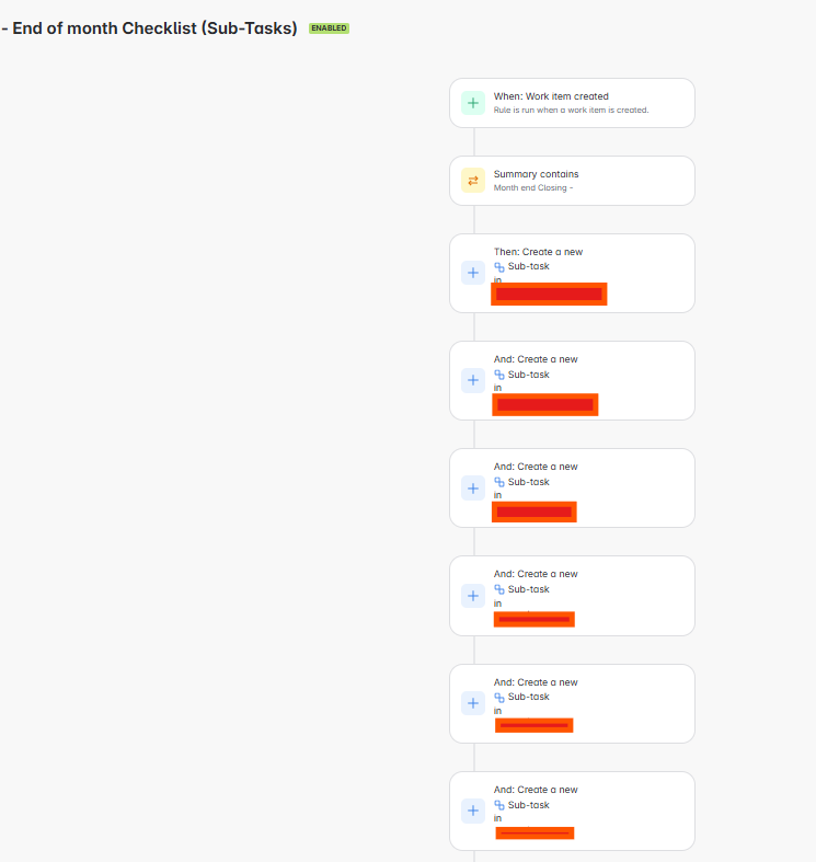

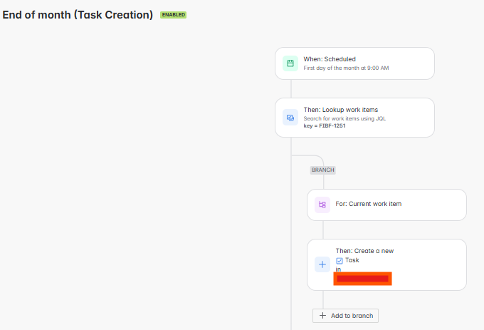

I was able to do this task but, in another way, I created an Epic named Month End and a Task named Month End June which contains all subtasks which I reduced from 67 to 43, we created two automations one for the task and the other for subtask. so, each month a task will be created with all of its subtasks, but I want you to take a look because it's not an optimized method of how I have done it.
these are for the sub-tasks I had to do 43 of these
Just note that I ditched the method of creating a new epic for it.
