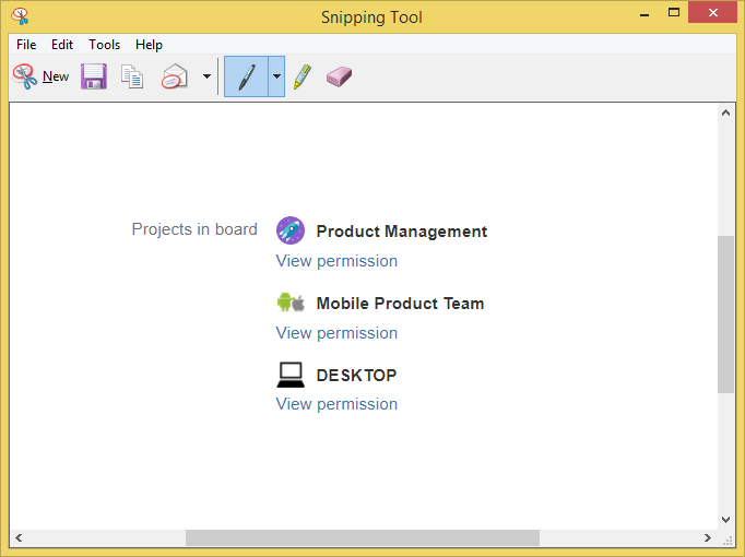

One of the users have created a kanban board and it shows 3 projects under configuration/projets in board section even though the filter query states only one project. How can I remove the two projects from this new board?

Filter query is  project = DES AND "Target Release" ~ A_win_1.0.0 OR "Target Release" ~ A_mac_1.0.0 ORDER BY cf[11200] ASC
These target releases are not being used by any other projects but DES. So, I am confused about these other projects are showing up on the configuration of this board?

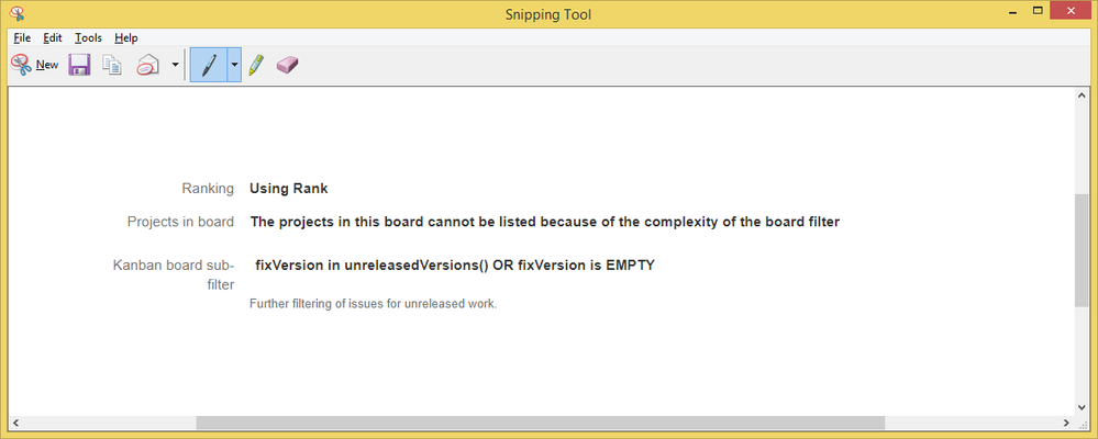

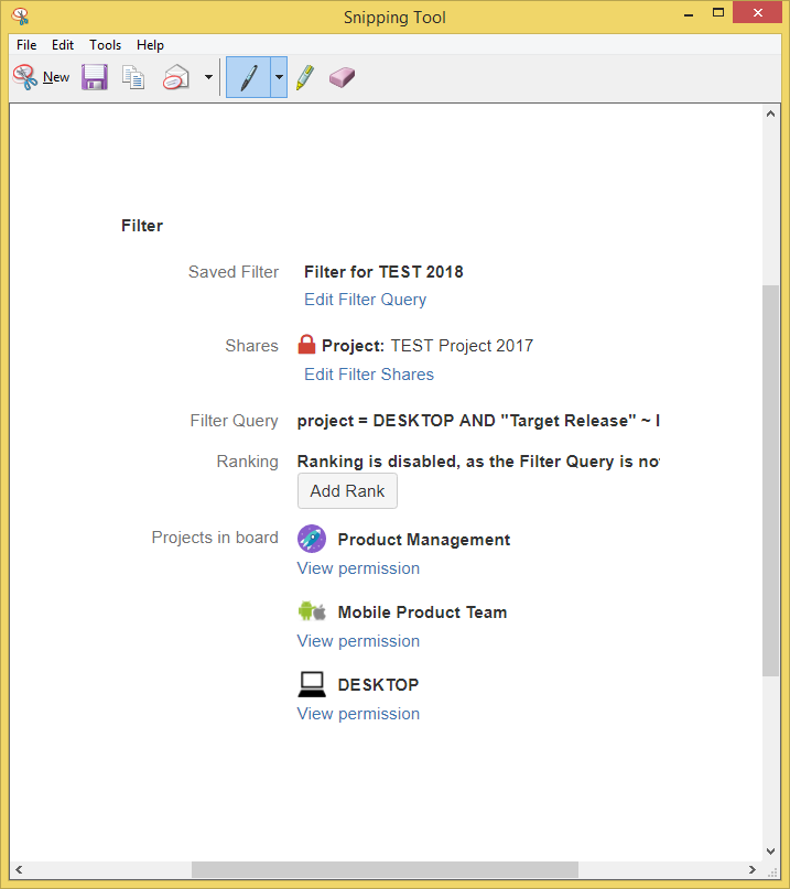

@Jack Brickey , we use server and if you go to board/configure/general you will see the " projects in board ". See the attachment below .
I created another one for a different project to see if I will have the same issue. Here is what I am getting now.
Projects in board : The projects in this board cannot be listed because of the complexity of the board filter
 Same exact filter query with a different project name:
Filter Query : project = "TEST Project 2017" AND "Target Release" ~ A_win_1.3.0 OR "Target Release" ~ A_mac_1.3.0 ORDER BY cf[11200] ASC
Elif Alverson
January 10, 2018
I have changed the project to DES and same issue occurs. I see 3 projects. So deleting and recreating the board does not help.

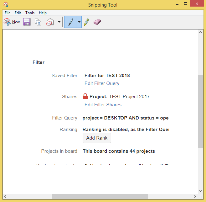

Here is the filter I am running :
project = DESKTOP AND status = open OR status = closed ORDER BY status DESC
and I see all the " open and closed " issues for all the projects not only for DES.
So, if you use " OR" in the filter query ;  "projects in board"  field picks all the projects which use the field you picked for your filter in this case " open and closed".
I believe this needs to be corrected by Jira team.
If you see my attachment below it says " this board contains 44 projects" . image.png
