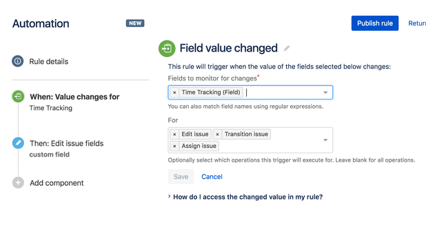

If that is the feature you are looking for, I can think of some options that can give you this functionality by using the plugin Automation for JIRA. Basically, you will need to create a rule that will trigger an action if the field is changed after the issue creation (Notification, change custom field value, add a comment, etc)  and use this action to filter the issues using JQL.
Please, allow me to give you an example of how I would configure this rule:
- Created a text custom field, But I didn't add it to the creation screen of the issue
- Created a rule that will add a value to the custom field every time the time tracking is edited, after the issue creation:
Please, let me know if it works for you.
