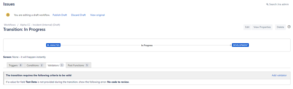

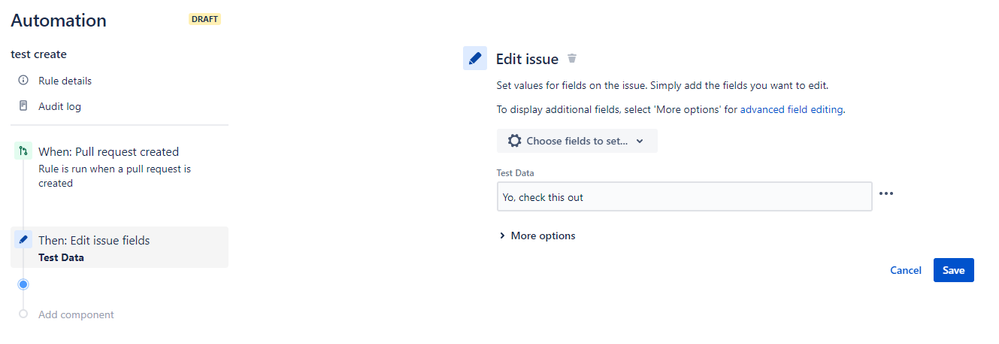

My answer may be unnecessarily complicated, but I would approach it this way:
If no PR has been performed, the field should be unpopulated and the transition should not be possible.
Note, I haven't tested this, but I believe it should work. There might be a problem with validating that the PR was done before the problem got to "in progress". It might be safer to set it up with a condition that compares it to a "custom number field" that is updated the same way (instead of text). This way even if it happens before it gets into such status it is possible to transition.
