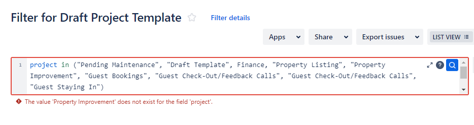

I am using a JQL filter query for a multi-project board and renamed a project (from "Project Improvement" to "Property Renovation" and created an additional project (Process and SOPs) and both of them were added to the multi-project board. I tried changing the filter query but it is still using the old name of the re-named and states that "Property Improvement does not exist for the field project" I am unable to see the tasks and sub-tasks for both Project Renovation and Process and SOPs.

I did this but I was unable to see the save filter button. I wrote all the projects again and was able to save it.
Hi @Sehr Jamil Aslam - Can you add a screen shot if possible ?
