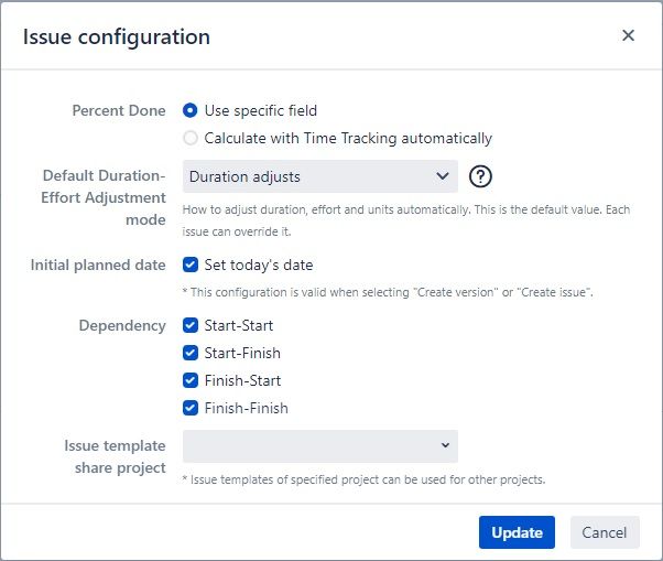

I use the cloud version of WBS Gantt-Chart Jira.
I read here that it's possible to reuse issue templates in different projects https://docs.ricksoft-inc.com/wbs-gantt-chart-for-jira-cloud/release-notes-wbs-gantt-chart-for-jira-cloud-1--31
But in the field "Issue template share project" of the configuration settings I can't find any issue template share project (1).

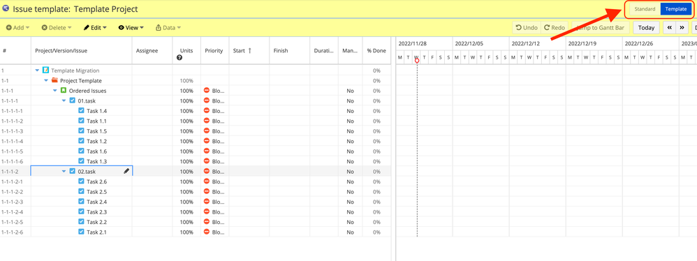

At the same time here I read how to create issue templates: https://docs.ricksoft-inc.com/wbs-gantt-chart-for-jira-data-center-and-server-0914/managing-an-issue-template . In the site I read to use the option "issue template" (left picture), but in my view I can't find that option, as shown in the right picture
In the Issue template share project field, you need to insert the name of the Project in which your templates are stored; Sometimes it can be confusing if you are looking for the WBS Gantt-Chart name instead.
There are some differences in the user interface for WBS Gantt-Chart Server/Datacenter (On-premises) and Cloud.
The article you fund was referring to the On-premises version of the app. The template view is available when you open a Gantt Chart using the following path from your Jira's top navigation bar:
Apps -> WBS Gantt-Chart -> Your Gantt
Then, the Template will be available as a button on the rightmost corner, as seen in the screenshot below:
In case you want to read more, this is the link for the Cloud version https://docs.ricksoft-inc.com/wbs-gantt-chart-for-jira-cloud/managing-an-issue-template
