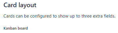

I cannot find anything suitable for the card layout. Neither status nor anything concerning (test) execution.

information about the testcase execution status. is this shown in a field?
if so then you can choose to show that field directly on the card,
go to board -> configure -> card layout
