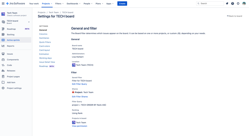

Clic edit filter query on the page in the screenshot you gave us.
You have to add in the filter the different projects you want to cover and save it and all the project you put in the filter should appear on the board.
for example your JQL might look like this....
project in (TECH, ABC, DEF)

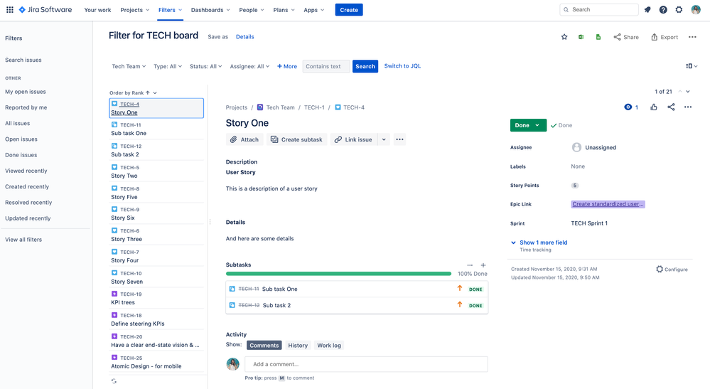

Thank you for your quick response Flavien.
I tried to click on "edit filter query" and this is where I am guided to? Very random view of an issue?! Any ideas?
THANK YOUUUU

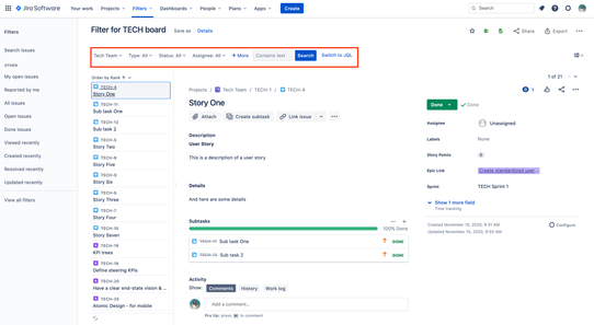

Ok so once you are on this view, you just have to indicate the projects you want to see on the dashboard.
How ?
In the red rectangle, click on "Tech team". A select list should appear with checkboxes. Click in the checkboxes corresponding to projects you want to have in your board.
Then click on the Save button, just on the right of "Filter for TECH board". And normally, if you go back to your board, tasks should magically appear :)
