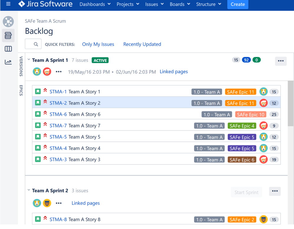

Hi! I was wondering if there is a simple and easy way to see how many issues have been assigned to a specific person. I found this picture as a reference

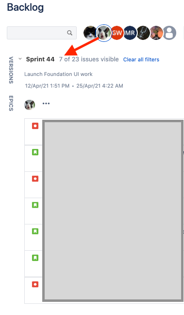

Typically next to the Search box (to the left of "Quick Filters" above the sprints) there is a set of Avatars for the assigned users. Click on the avatar and each list (sprints and backlog) will be filtered to the issue assigned to that user. At the top of each list will be the text "# of ## issues visible". That tells you how many issues in that list are assigned to the selected user.
